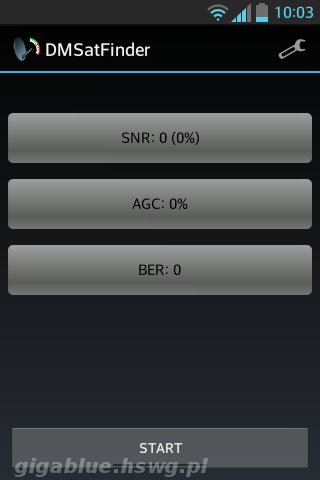

    A small application, available free of charge in the Google Play store DMSatFinder allows stress-free antenna placement. The idea of ​​using Piotrek in the commentary to Smartphone, Android and Gigablue, or cell as a pilot controlling the tuner. In order to fulfill its task, an android phone must have access to the tuner through a LAN (most commonly WiFi) or WAN (required port forwarding on the tuner in the router). Of course, the tuner itself must also be plugged into the network. The application launched immediately after installation looks like this:

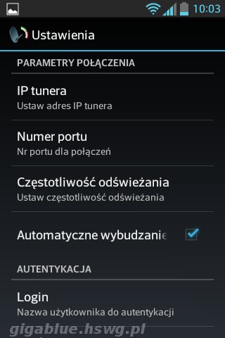

    To start work, you need to configure the connection - we are interested in the key icon in the upper right corner of the screen:
    If the password was not set to the root user in the tuner, we did not change the port, it is enough to enter only the IP. After returning to the main screen, simply press the START button and you can set it by watching the signal level indicator:
