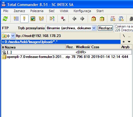

    How to install image in neoboot Download the image from the uploaded file without unpacking .zip
    you send via ftp to ImagesUpload
    0: / media / USB / ImagesUpload
    0: / media / HDD / ImagesUpload
    depending on the neoboot installation location

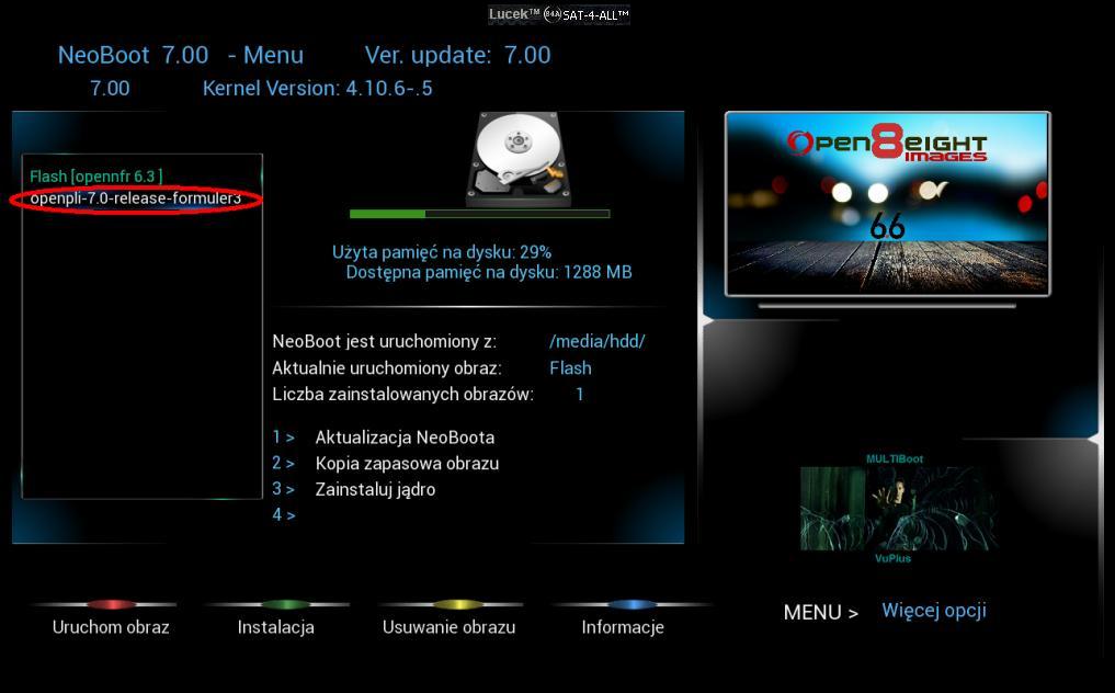

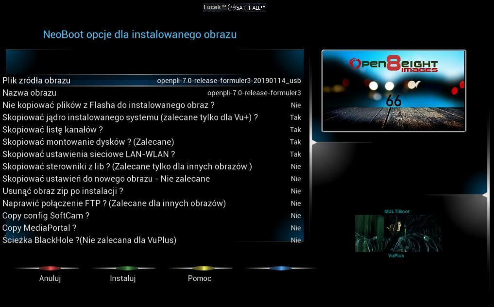

    Neoboot / Setting / Install
    When installing the cursor, you go to the installed image and confirm OK
    The tuner will start from the selected item

    4. Menu> NeoBoot and here press on the remote control successively, blue - Device Manager, ok, choose for example the cursor [i] Mount: / media / hdd Mount: / media / usb [/ i] and press green to save
    5. We return EXIT to the neoboot installation on a usb or hdd disk
    [Img] http://zapodaj.net/images/6297effa260d0.jpg [/ img]
    6. We choose on which medium we want to have neo and install -OK
